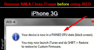

2- While many users are flashing firmwares with the SIM card inserted, it is not needed and can only create problems so I always: Turn off the iPhone & remove the SIM. There is no need to reinsert the empty SIM tray nor to turn it back on at this point.

7a- This is optional but can prevent many iTunes installation errors: download the free iREB and with iTunes turned off, use it to get the iPhone in the PWNED DFU mode and after that close it & use iTunes to follow the steps below.
Note: some users had problems with the current iREB r7 so you can download the stable iREB r6 here which works fine.
7b- In iTunes, select your device in the Sidebar and click on Restore holding SHIFT (Windows) (or ALT on Mac) at the same time and navigate your computer to where you unzipped the whited00r Software Update (.ipsw).
