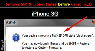

4. Use the free iREB to put the iPhone 3G in iReb PWNED DFU mode before using iTunes to update to the Whited00r 6 firmware and prevent iTunes errors 1015, 16xx, 1600, 1601, 1602, 1603 & 1604. You can also use iREB if you are stuck in a Recovery Mode Loop after flashing Whited00r:
