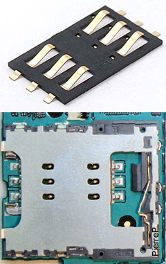

5- If it is still not working, turn off the iPhone & try with an other known working SIM. If this is not working you may have some broken SIM junctor reader contacts like in my friend's iPhone 2G from careless SIM inserting. The part is cheap on Fleabay but it's a 1 hour job replacing it & requires soldering. With the SIM tray removed, you can try to look inside the slot with a magnifying glass & a flashlight.

Thnxxx guys oh n by thé way it's a "she" haha im a girl :p so i dont need to downgrade it ! my sim was working before all That n now there's "no sim" not even no servise or somthing :/ i guess it not possible that the problem is in the sim  junctor reader because it was workin so i guess it cant just broke while restorin' the iPhone right ? Also i did try others sim :/
