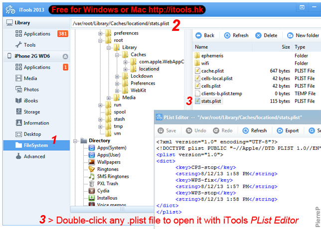

Now I have an iPhone 2G with exactly the same specifications as you wrote above: iPhone 2G Whited00r 6 (based on a customized iOS 3.1.3), baseband (General > About > Modem Firmware) 04.05.04_g, > Settings > General > Date & Time set correctly, > Settings > General > Location Services: ON and I also have the "Your location could not be determined" error in Maps.  :-\
The only difference is that the SIM reader is broken so I can't use a SIM in it. Consequently cell towers triangulation cannot be used.
When using WiFi triangulation to approximate your location (because there is no GPS chipset in this model), the iPhone 2G tries to connect to a database of known WiFi IP's but fails because Apple broke the access to that URL on iOS below iOS 4 and the iPhone 2G cannot use any iOS above 3.1.3 on which Whited00r is based but customized and tweaked.
Maybe your iPhone 2G locked on cell towers or maybe on a known Wifi's IP. Could you please use the free iTools (click on English), connect your device > click on FileSystem and paste this in iTools' navigation bar (or navigate to it): /var/root/Library/Caches/locationd/stats.plist
Now there is a neat .plist editor in iTools so you can double-click on stats.plist and copy the content and past it here. For example, on my iPhone 2G without SIM & WiFi triangulation not working:
<plist version="1.0">
<dict>
   <key>CPS-stop</key>
   <string>8/12/13 1:58 PM</string>
   <key>WPS-stop</key>
</dict>
</plist>
Compare to this one from an iPhone 3G running Whited00r 6 that locked on cell towers (CPS-fix), known WiFi IP (WPS-fix) & GPS satellites (GPS-fix + Sats-found + Sats-unique, not possible on iPhone 2G because it does not have a GPS chipset):

here's the stats.plist
  • Posts: 2026
Re: No location services iPhone 2G - Maps Location Not Determined
« Reply #28 on: August 19, 2013, 09:31:54 PM »
Hi, PierreP
I'm faced with the same problem :)
Welcome to the Whited00r forum!  8)  And thank you for providing the screen captures so +1 Internets for you.
That's for an iPhone 2G, right? For which iOS version if not running Whited00r?
Maps times out very fast and your stats.plist shows locks for both known WiFi IP (WPS-fix) & cell towers (CPS-fix). Did you try repeatedly to re-activate Maps by tapping on the button bottom left (arrow or cross-hair circle depending on iOS version) after every time it says "Your location could not be determined"?
Could you try with the free & compatible GPS Info! in iTunes to see if it reports anything?
